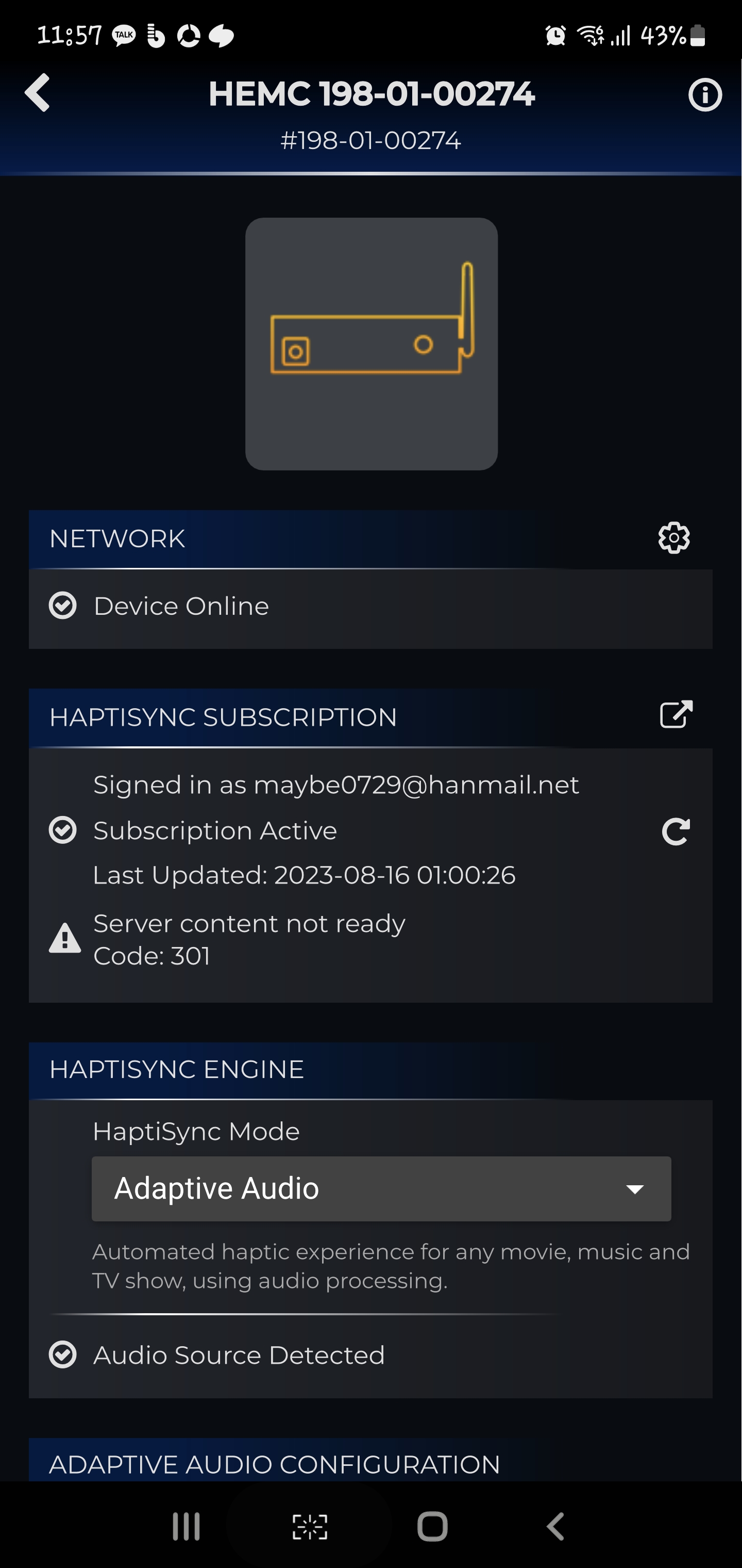

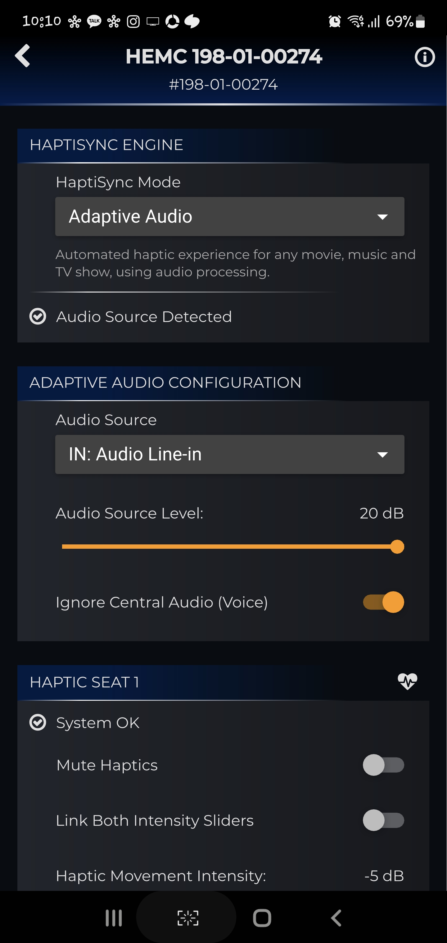

The motion code works fine, but when I change to adaptive audio mode, the motion doesn’t have any movement. Having trouble using the adaptive audio mode?
Does the adaptive audio mode work normally?

I know that the experience of watching a movie with a D-BOX code is different from watching a movie in audio mode.
However, my D-BOX has no vibration or motion in audio mode.
Nothing works.
Is there a problem with the product?

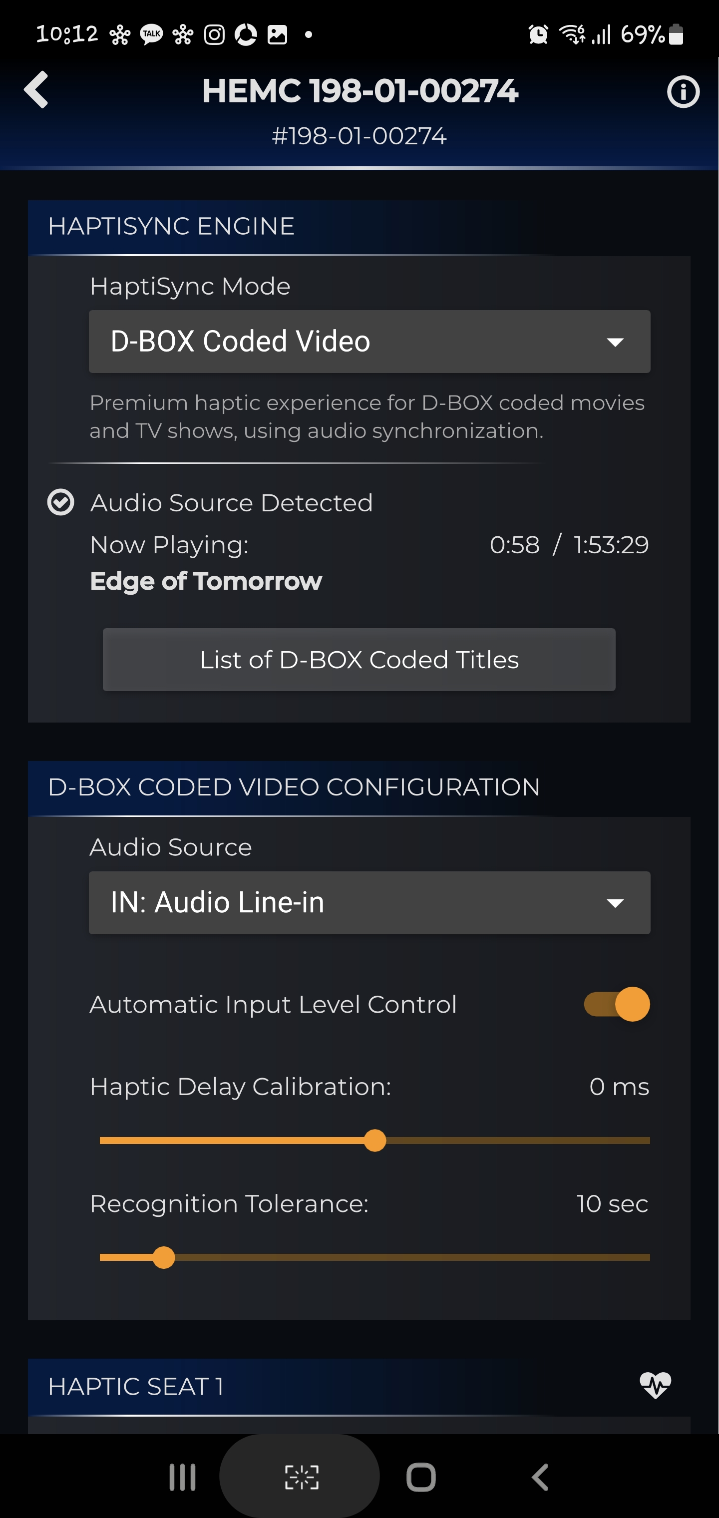

It operates normally in D-BOX CODE MODE.
Is there anything I need to set aside?

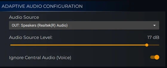

As all movies (or games) have different soundtrack and style, you might have to adjust the Audio Source Level to optimize the haptic feedback.
Note: Using the HaptiSync Hub/D-BOX VIBE microphone or a HEMC optional microphone is not recommended for this mode.
Of course I also tried turning the audio source level all the way up.
But adaptive audio still doesn’t work. The motion code appears to be working normally, so it doesn’t seem to be a hardware problem. Do I need to modify my software?

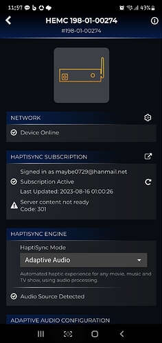

Having the same issue here. My Motion 1 has no response to any kind of audio output. It works normally for coded content.

Hello Rickson, can you provide more details on your device? Are you using an HEMC or Haptisync Hub? Can I get the serial number from your device? You can normally find it on the top of the App’s screen.
